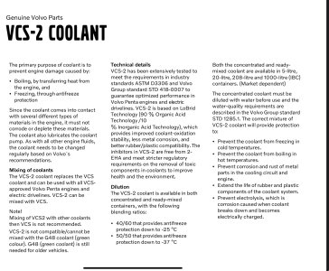

I have a Volvo MD2040D which should use Volvo Green antifreeze.
Is there a Halfords alternative?? It all seems quite confusing with many types and no industry stand for colors.
FYI it is not so much due to cost, but Halfords is local and Volvo is not … a question of convenience and speed to get it.
