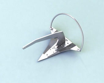

For those who like anchor threads there are couple over on Cruisers Forum that are reaching reaching an interesting stage.
The key player seem now to be Viking Anchor https://www.vikinganchors.com who are stating they have reached the production stage - and the prices look interesting - though freight might be an issue.
The threads started from a open source DIY anchor thread and then morphed into the introduction of Viking.

The roll bar looks a little flimsy
Perhaps without the roll bar, and with a rather longer shank, it might make a 'weapon of war' a Viking would be proud to wield.

This one looks a lot like a Mantus derived design, except someone had access to a laser cutter and got a little bit too excited about it. The shank is also quite a bit shorter.
The flimsy looking rollbar probably doesn't matter - there isn't usually much load on those. Although we have retrieved our Rocna by its sturdier rollbar once or twice when forced to anchor in rock, so you want it to be at least strong enough for pulling the anchor out backwards and lifting it up by the rollbar.
There's also a gimmicky retrieval nook in the shank, which I doubt will work well in practice with their poorly named "Anchormate", which is quite obviously just a bicycle locking cable. It will however make it even more difficult to fit well on a bow roller without chewing it up.
Prices are good, and making a modern generation anchor more accessibly priced is excellent news for everyone who likes anchoring. I wish all the boats around would have a good anchor (and know how to use it), so I don't have to worry about them dragging in the night.

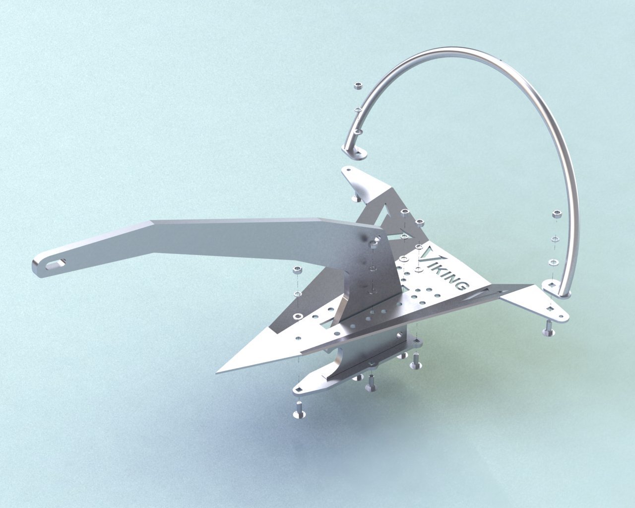

Lastly I couldn't help but notice there's at least one hole missing in the illustration of the assembly. Hope they didn't forget it in manufacturing, else it'll be a bit tricky to assemble.

Bouba's comment is actually valid - roll bars do take some punishment and can bend, I have a picture of a slightly bent Mantus roll bar. Viking claimed in one of their posts the anchor, all of it, was based on a high tensile steel - which is unusual (flukes are usually mild steel) but the fluke, shank and maybe roll bar are all, said to be, HT steel - which at least means the fluke might not bend.
Well spotted the missing hole in the drawing/illustration.
It has some significant differences to the Mantus which might make it perform more acceptably than Mantus. I am sure Noelex will be along to explain - he is an expert on Mantus - though a bit short on detail :)
Anchor development is incremental - there have been very few original designs - I'd single out Bruce, SARCA and Spade - the rest have all copied something or a lot from others.
Peter Bruce patented the roll bar. Gordon Lyall developed that specific shank shape (common to most anchors today - even Spade), the fluke shape, those angles and breaks in lines of the fluke are common to Spade, Rocna etc. In fact if you lay flukes one on top of each other - they are much more similar than different. The removable shank, Spade and then Anchor Right Aluminium Excel, bringing the shank up from underneath - Anchor Right aluminium Excel. The only perforated fluke anchor I can think of is the SARCA - though it has more pronounced slots.

I was flattered that one of my articles was linked to the design, which has aroused my interest and I have been following developments (one reason for the thread). The modifications or changes making Viking significantly different to Mantus are not as far as I would have gone - but - in theory - it should be much better, nearer Rocna than Mantus is close to a Delta. Wait for the feed back....
And to re-assure - I have no involvement in Viking, at all - except they took one of my articles to heart, read it and understood (and authors like it when that happens :) ). It merits note - the article also illustrates why some designs don't work. Whether it infringes design or copyright - I have no idea - but if this were an issue - maybe some proof should be produced before accusations (not suggesting you Yngmar, are suggesting anything) are thrown about.

If you compare the illustration provided by Yngmar of the Viking in post 13 and compare with the design now - you will notice some subtle changes. They have not gone as far as I would have gone, so they have the opportunity to increase hold further, but maybe the thin fluke gives them the extra hold they need.
