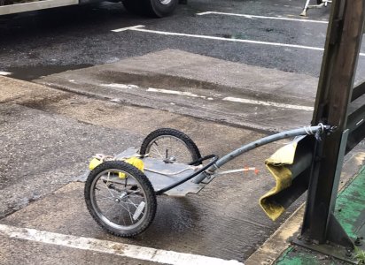

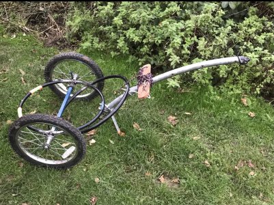

What trailer? Is it axle or seat post fitted? I did try making a folding one for the boat to carry 20 litre fuel cans, but got the shape wrong.
But I would like a decent one. Possibly not too big. Just to take stuff to the marina 4.4 miles away, for exercise rather than use the car. My feet & legs are making the pedals difficult to use in the car
This one
It is a work in progress
But it works really well and ways less than a Carry Y Freedom (£500) which I regard as the gold standard for these things ..
I have an axle attachment but I prefer rest of seat because then it becomes a pontoon hand trailer too
I use a Burley seat post clamp, £35 or so..
And now it gets silly:
The Q/detach wheels came off a childrens chariot
The Axle bearer underneath is a square section steel tube ex cage
That is welded to two ex wheelchair hoops welded and gusseted to form the base frame and frontleaning upstand curve.
To this is attached /via two car exhaust clamps - one section of a trampoline frame in steel , nice curve perfect for seat post or hand trolley .
And the ‘Handle’ is just a bit of 6mm threaded bar with two nuts and duct tape. At this time 😂
And the ‘ hinge’ which works brilliantly as it is also rattle free , will twist yet absorb road shocks or tug-Iness from the loaded trailer, this is a car alternstor belt fed into the trampoline tube and pinned with a bolt.
And this lot weighs 7kg and has stayed in this current iteration over a year now .
I haven’t even painted any of it pretty yet but I reckon the geometry is all about right and that’s it and it all knocks down flat for a cockpit locker or hatchback..
One for your workshop perhaps ?
I’ve carried paving slabs , petrol lawn mowers and bags of cement, sand and plaster..
Go on, you know you want to .

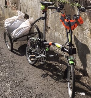

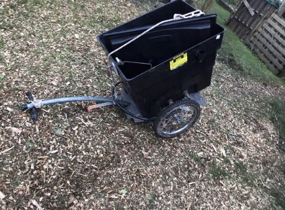

Couple more silly pics and one of a Y trailer which would do you a treat probably too
