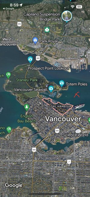

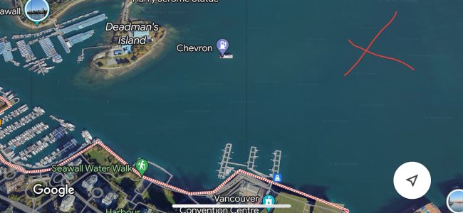

I’ve marked the approximate location of the collision. The area may be designated as priority for float planes but it is not exclusively reserved for them.
As can be seen from this image, boats need to transit this area both to and from the yacht club/marinas and to and from the (Chevron) fuel dock. There’s a whole chunk of land due west of each of those that prevents access to the Pacific that way!
