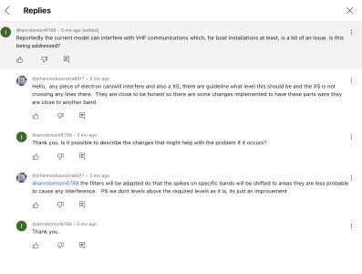

I am too having issues with interference on CH16 when the Orion XS is delivering a relatively high current (above 20 amps). ... It seems to impact CH16 more than any other, we regularly use CH72 and there is no interference present.
