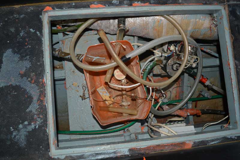

Bilges are clean no signs of soft wood anywhere. Engine room the same. Electrics seem ok, and like all the other 70ies Italian craft, they have a pressurised immersive tank for hot water (operating at 220V!) Guess will have to repipe things and install a proper hot water tank. No waste tank either...

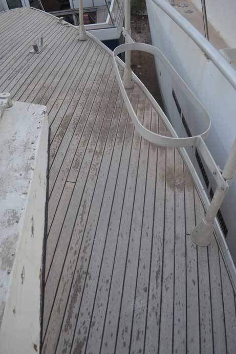

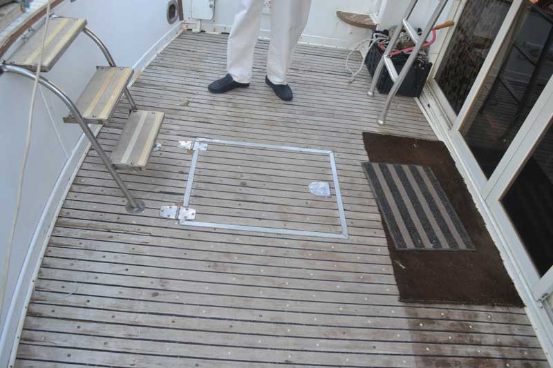

Teak deck aft and all the sides going to the bow are 4mm :eek: teak glued to the old teak deck. Sikaflex has been used to chalk them in. At 4-5 places it seems that this new (15yr old) deck has lifted off the original and it's soft to the point it reaches the level of the old one, so seems that the old one is still solid...

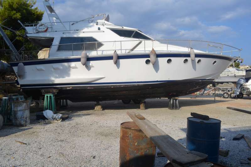

First of all the size, seen it advertised as 42, 43 and the UK built GRP as 14m something (45...). OK, not big deal, but legislativewise here, the shorter the better (i.e. as in lower taxation, berths are free where I am ;) )

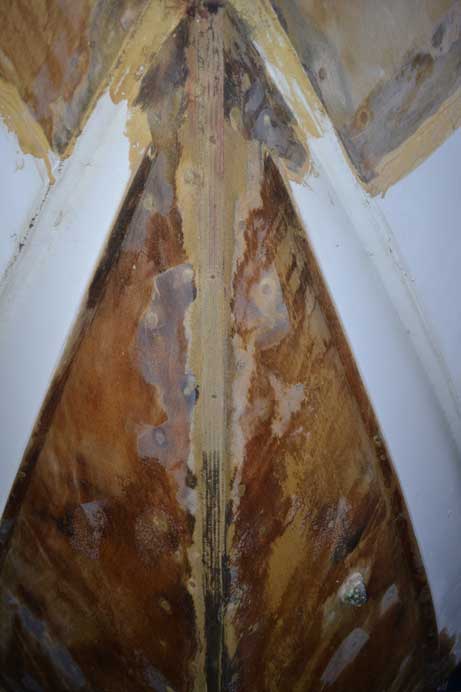

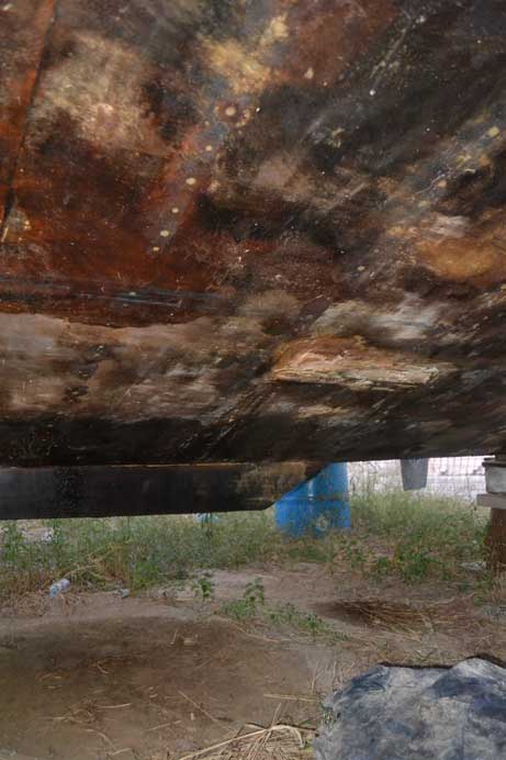

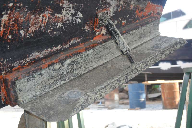

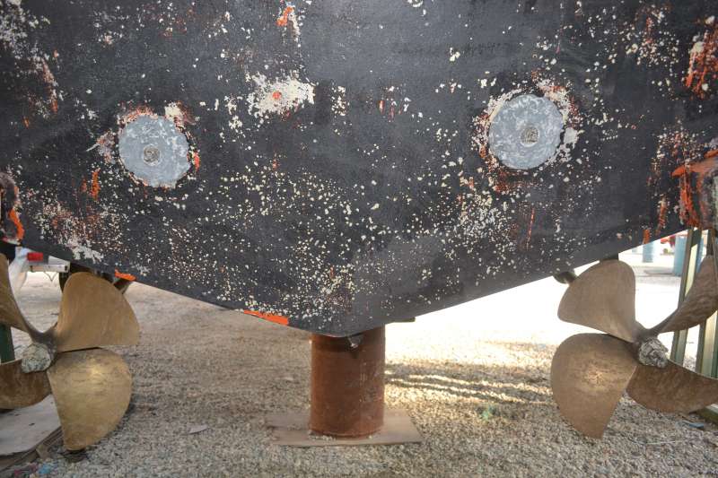

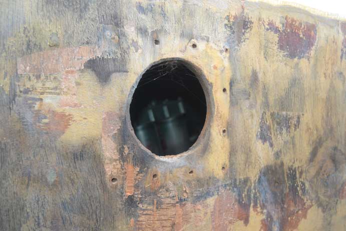

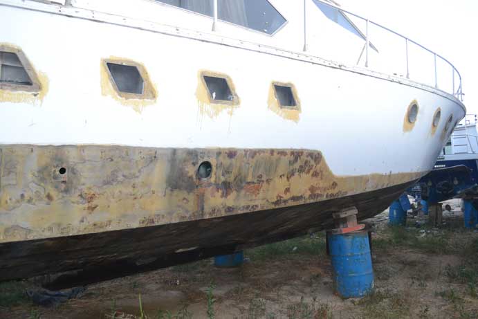

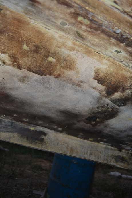

Also not sure about the construction method:
that's the side view of the hull and
is a detail around the exhaust area (usually covered, now removed the cover to check the overall condition of the hull.
keel and
detail that looks like marine ply to me...

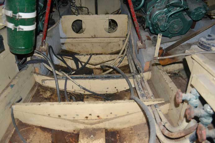

finally check this interior of the hull at the engineroom, looks like there were I layer of timber (planks I'd call them in building eng terms) and the rest layered on top?
Other than that, bilge looks okayish

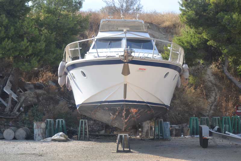

Teak decks need redoing (all of them, not a trivial or cheap job...)
and
typical exterior condition on all wooden surfaces that mean a lot of work to sand down, clear and primer/repaint.
Now, I finally am not at all sure that the finish obtained after all the effort that will have to be put to it will be worth it. OK, the external marine ply of the superstructure if sanded carefully should provide some decent finish.
However, the rough sanding of the hull, with some material removed here and there and around airducts, hull holes, windows etc will be a nightmare to filler decently and get straight and not wavy lines for the hull, the chines et al. Is it worth the effort when all the grp crafts will be straight as it can ever be without any effort???
I confess I'm a bit of a perfectionist and wavy hull surfaces will annoy me everytime I see it...
We shall see, but doesn't look too promising atm. Interesting to see what the two Italcrafts will cost overall to buy and put together properly.

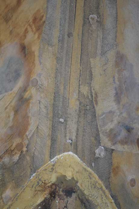

Yes, indeed there is a keel, just looking through the 150 odd photos I took to find the right ones:
towards bow
the ending of it at 3/4 level to the axles coming through the hull
and from the inside if it makes any sense (not sure)
I'd hazzard a guess that they couldn't be bothered to sort out a keel in the mould, it must be much easier to do that in timber :p

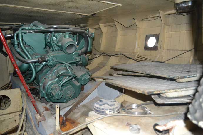

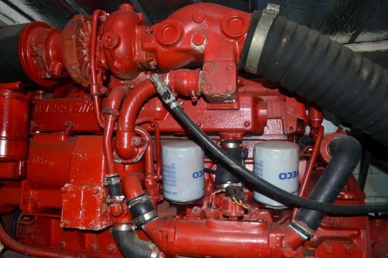

Hello all,
On Thursday I viewed another Mystere 43 (or 42 or 45 or whatever I don't care anymore....)
Built 1976, brought to Greece from new, two owners. Current owner for last 30years currently in his 70ies and on sale due to health problems. So all looks ok on this front.
Basic points:
Hull out of the water annually, scraped to bare wood (pretty sure it's marine plywood), primed and coated and antifouled. Hence, there's no zillion coats of paint and antifoul on right now, hull is simply scraped, no paint removed but on a few spots as it stands out of the water now.
MystereMarcus, this one also has a 3/4 keel, identical to the other one, so I guess all of the original designs had it.
Last year owner had to get it out and patch/replace an area 3 by 2 ft on the port side of the hull plus another 6 by 3 inches. He didn't like the repair and the way it was carried out (neither do I!) and I'm a bit worried that there are more problems to be found but will check again. Work had to be done in a rush, so not on his normal place but on an island with unknown labour that obviously did a poor job.
Having said that I've spend a good half hour under the hull poking it with my car key (got to remember and bring a couple of screw drivers next) and no soft spots could be found.
Seems that no expence spared as far as engine and subsystems maintenance were concerned (which is a good thing and it really shows in the engine room which is the best I've seen).
Compared to the first one, this has EIFO engines 8061SRM33 (330hp) installed in 1999, brand new by the Greek dealer and serviced annually from them. Owner claims 55-60lph on 20knots (way too optimistic, The owner of the previous mystere I've seen with the cat 375 engines claimed 80lph for both engines. Divemaster on a similar hull gets 110 or so lph on his setup, we shall see...

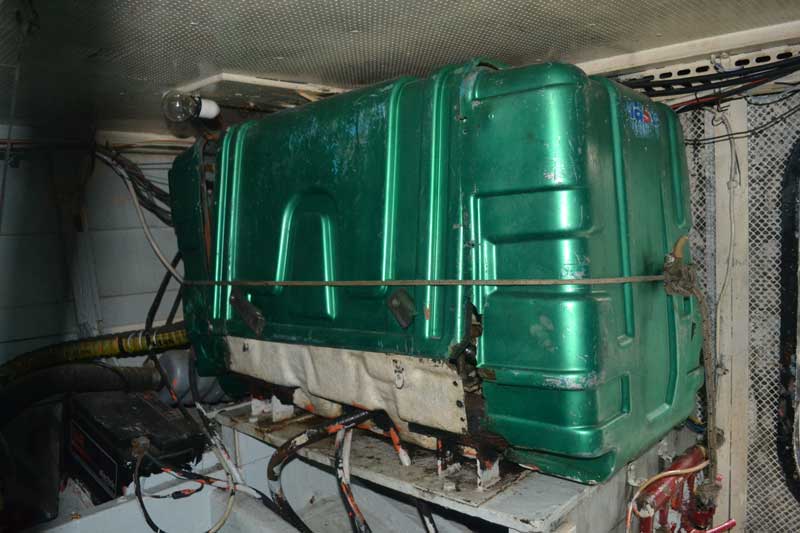

There is a green coloured MASE (sp?) gen at 8kw or thereabouts, couldn't find the label with specs/serial #, 4 new batteries and all usual stuff.
Stern gear is cleaned and looks okay.
Interior is shabby at places, B- at others and generally used (not abused though) heavily and worn. Seems that the owner spend long periods of the summer on the boat, gen has 900 odd hours.
As far as the cabins and heads are concerned that's no prob as I'm currently having a go in AutoCAD redrawing the layout and trying to gain two extra beds in an semi-open plan layout on strbrd side where the two heads were. Plan is to remove the crew cabin in the bow, shift the master bedroom forward and getting the two heads on the port side. Only thing that remains intact is the two single bed room on port side. Seems to be feasible and quite excited about the renovation prospects.

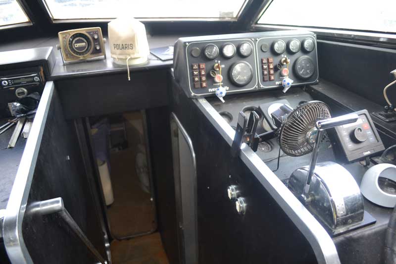

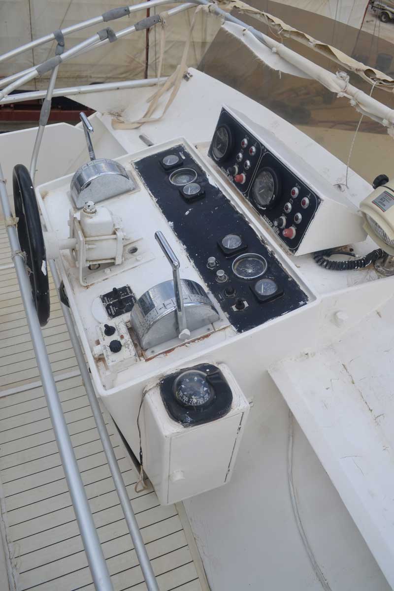

Helm is basic (to spartan), but new controls for the EIFO engines are bolted on the back of the gauge panel and will have to get intergrated replacing the stock ones.
There is a old school autopilot and depth thingy no radar and no gps, so will probably have to fork out for a GPS/depth/autopilot device, pref 3 in one not to clutter the dash.

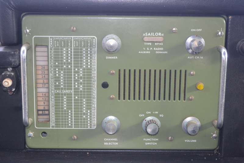

Got a 70something vintage S.P. Radio which I'll probably be keeping as it looks brilliant (got to figure out if it works though and if it has any use as a vhf or not...). There's a normal vhf (very plasticy and godawful 80ies design).
Aft of the helm position is a nice detail with 7X6 flags.

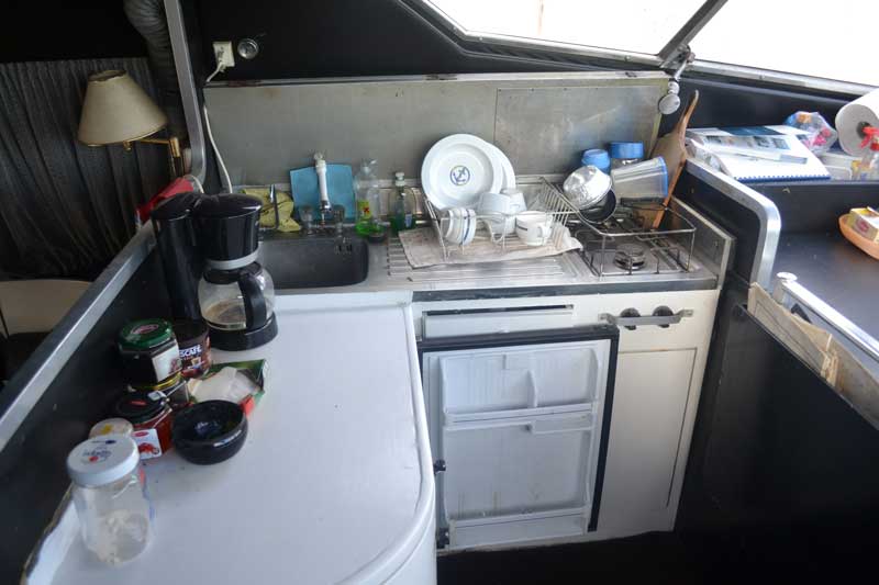

Galley needs a lot of TLC but nothing exceptional.
As in all the crafts I've viewed (70ies italian stuff) there's no black water tank, two electric sea toilets and a electric immersive heater (!)
Fuel tanks are two totalling 1200lt in the proper position (to the front of the engines). Engine room is rather spatious which is a good thing, cabling is relatively well organised (bilge pumps are slightly messy, have to be checked carefully)
Water tanks are also two (?) symmetrically placed to the aft of the engines look like 200-300 lt each.
On the outside, the teak deck going to the bow is covered with marine ply and glued on top is a 2mm plastic thing that looks like the typical eighties bow deck (white with black strips)
Not in a v.good state but could keep it for a couple of seasons before removing all that and refitting new teak (depending on funds).
Aft teak deck will need replacement soon as sealing is going, but not too badly yet.
Exterior needs scrapping and priming/painting everywhere, the black surroundings of the helm windscreen is painted white and it's removing some of the design lines - easy to fix.
Flybridge helm is in need of serious renovation/redesign. There's also a bimini frame up there.

Divemaster1
15 Jan 2002
4,450
Aberdeenshire, Scotland
.....On Thursday I viewed another Mystere 43 (or 42 or 45 or whatever I don't care anymore....)
.............Compared to the first one, this has EIFO engines 8061SRM33 (330hp) installed in 1999, brand new by the Greek dealer and serviced annually from them. Owner claims 55-60lph on 20knots (way too optimistic, The owner of the previous mystere I've seen with the cat 375 engines claimed 80lph for both engines. Divemaster on a similar hull gets 110 or so lph on his setup, we shall see....
Looks like she have some good potential.....
Let's be honest about fuel figures :
Average diesel of that age will bun roughly 200 grammes per Horepower hour...
Marine diesel weight is approx 0.86 Kg per litre...
This gives 200 gramme * 0.86 = 172
as there are 1000 centilitres in each litre divide this by 1000, and you'll get 0.172 L per Hp hr.
Take that and multiply by the engine power ... this time 330 hp and you get slightly below 57 Litres per hour.... multiply this by two engines and you'll get 114 Litres per hour.
I'd hazard to guess that with 660 Hp on tap, with the wooden hull, 20 knot is about max speed...... and as such owner is not wrong stating about 50 L per hour .... but failing to state that it is for each engine...

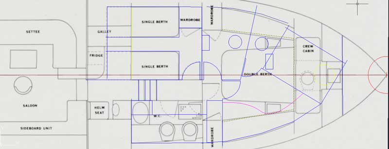

In a seperate PM you asked about layout... so here is a poor image (will try to find a better one).
Thanks for the analysis Alf, explains how it should be.
Few points:
owner claims 22knot cruise and 28knot max speed. That is close to what the owner of the first one with the Cat engines mentioned. So don't know if they're not heavy as we'd expect them to be. BTW, engines are 575kg each dry or 640kg with the ZF-MPM 220A-1 and 670 with a twin disk MG 5061 box. Needless to say I've no clue which one is on, will have to check.
Got no specs for the craft (weight, installed power from factory and consumption figures), versilcraft website is non existant and I've not managed to source any info elsewhere.
Mind you owner claims that 20knots is around 2000rpm, so plenty of revs to go up to the max speed on WOT (what 2.5K or 2.6K rpm?)
So on these accounts, maybe consumption figures could be re-evaluated downwards from 110lph to the 80 or so that the owner of the cat engined mystere claimed for 20kt cruising.
Anyway, discussion is becoming rather academic, unless I get it and do the 190nm trip from Athens to Volos I wont really know how she behaves and what the consumption is.
A larger plan would be nice, although it looks like we're following the same lines but seems that the shorter length on the mystere is difficult to get all in place. Curious on the srtbrd room and it's layout, I guess just one bed, right?

new info and photos following a second visit last Friday.
Was trying to figure out if what the skipper was saying was true, if there are any hidden issues with the craft and generally the overall condition.
Started with half an hour poking with a sharpish narrow screwdriver the hull trying to find soft spots and other signs of decay. None was identified, all plywood seems fine (except for the dodgy patches done two years ago in a hurry)
Had a look at the bilges at the middle and had a pleasant surprise with a spagetti setup that was plain joy to figure out what is doing what...
Plumbing for the heads was in a better state (slightly...)

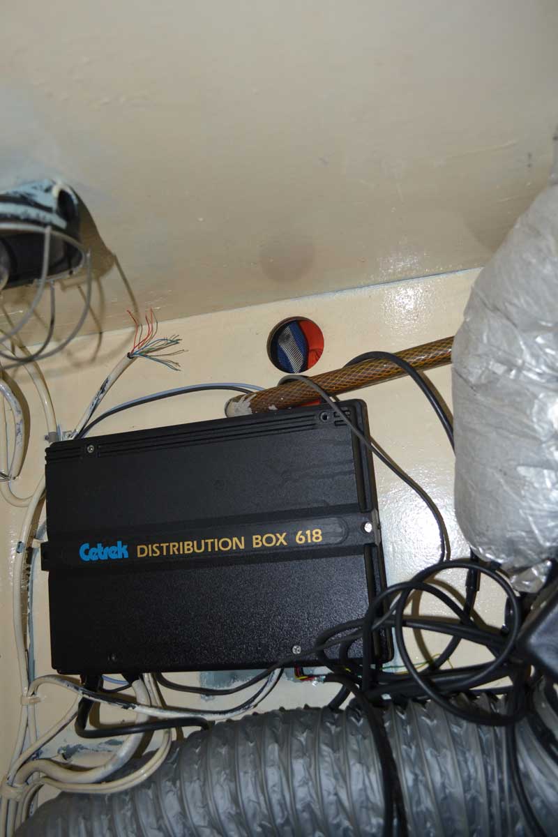

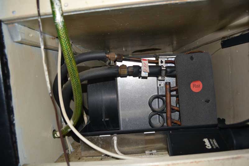

Spotted the autopilot box (got to read if it's worth and can interface to a garmin plotter or it is to be scrapped)

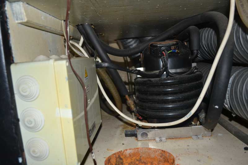

and the aircon where I was planning for an extra bed (still attainable)
Had a hours talk with the skipper who confessed that the owner being bored and with a bilge pump psychosis would often alter setups and plumb new bits and complicate things just to make sure everything is safe (which clearly aint!)
The owner as it appears expressed all his creativity in electrical modifications (seen around the masterbedrm and to a lesser extend in the salon) hence counted 6-7 bilge pumps around (keeping the sliding door of the salon open, etc).
It also seems that being rather overweight, the owner couldn't easily fit through the aft deck hatch to the engine room hence the damage there is much smaller and again relates to the bilge pump...
Overall, it looks like it's a good craft and if paperwork is okay (should know first week of Sept) I'll go ahead (pending engineer and carpenter report).

third visit yesterday, engines started and run with almost no smoke at all, very smooth and quite impressed. All looks fine, deposit paid and arranged for the mechanic to do a service, oil, filters, impellers, check of gearbox, engine, water heat exchangers, engine anodes and a few more bits.
Shore power is fine, service batteries sufficiently charged in an evening (4X110Ah ones) the two engine batteries were fine after 5 months on the hard.
I guess if the skipper had switched off the fuse for the refrigarator the service batteries would be also fine...
Gen battery (small car battery there) is empty, got to charge it through the others and start it, didn't have time though.
Things to do before the 190nm delivery trip from Athens to Volos are priming some parts of the hull exposed for checking, and a bit of antifoul on them since she'll stay in the water just for a month then off for extensive renovation/rebuilding.
