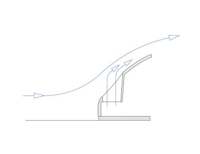

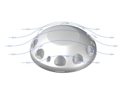

Images from the manufacturer on the 'ejector effect' and how this makes the low profile vents so effective.
