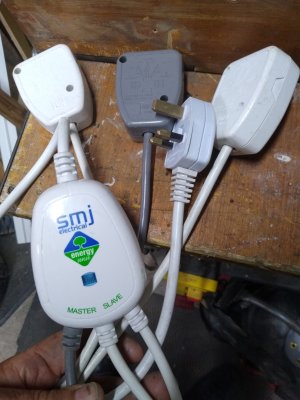

I bought 2 of these a couple of years ago about £10 each, for turning the vac on when using the track saw or mitre saw. They work great but when I tried it on my large table saw but it blew the integral fuse in the adaptor which wasn't replaceable so it's worth checking the load.

Where did you get that smj master slave item from. Google is not helping me today...

The motor on the table saw is 2.2kw. The hard to read moulded info on the adaptor says 6A so I guess that's the problem :oops:
It looks like they are no longer making them but at the time I bought mine it was 2 for the price of one from an Ebay seller.

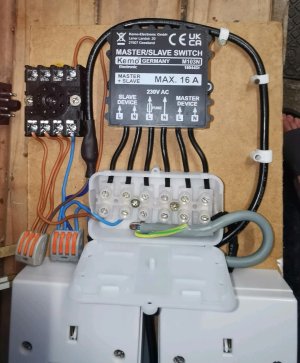

And now the issues with this set up (using a kemo 103M master slave switch)
It works fine for short time use.
On running the saw and vac for longer periods it cuts out
My fault, the table saw is rated 15amp, and vac at 5amp. Too much of the 16amp M/S switch
Could I fit a 240v relay to the slave side to switch on the vac?
Would that be a reliable solution?
Screenshot_20240802_220659_com.microsoft.office.outlook_edit_2406829034253049.jpgyes, that works!! Once the relay is plugged in of course
Next step is to box in the relay, junction box, & M/S switch.
