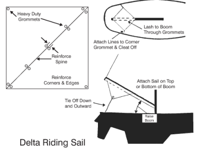

My favorite is a DIY design, first suggested by Paratech for use with sea anchors in serious storms. Super stable, super strong, and can be up-sized to serve as an awning. The KEY is that the boom is raised up to serve as a forward suport. This feature also makes it very adjustable. Lowering the boom and narrowing the sheeting base reduce drag and effectiveness. Wider and higher and it is more effective. Also easy to rig in windy conditions (some are not!), since you can rig it with the boom down, and then raise the boom.
over-boom riding sail.
My geometry was a little different, and I think the longer forward luff is a little more stable, but much depends on the sheeting angle to the stern cleats.
