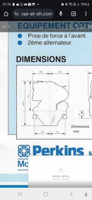

I am upgrading from my Perkins to a new Volvo on the advice of an ex Perkins dealer (rather than a reco). The theory was that the M50 is the same block as the MD22 and the MD22 should be upgradable to the M2-50 (2020+ version of the M2-55). I have a Hurth MIV15 gearbox (V drive) that I have tested the new M2 with. Other than needing to get a slight clearance of about 5mm by heating and knocking in the back lower corner of the sump (being done by the dealer) to clear the prop shaft that obviously runs back under the engine. Everything else looks to be the same. The engine mounts have the exact same dimensions as the Perkins by the looks on the spec sheets I have found. Both the dealer and the ex Perkins rep rekon it's doable.
Anyone done this upgrade or have suggestions, tips or potential pitfalls?

I think so. You mean sideways? Vertically the propshaft is the issue. The dealer set up the v.drive on it and using a 40mm shaft it was less than 5mm of an issue and I actually use a 35mm shaft so he's making the sump adjustment for a little extra clearance. I'm wondering however if the vibration could be an issue. Not sure of the weight differences and consideration for vibration Freq and amp. Its on a Wauquiez and from all reports they were well over engineered.
