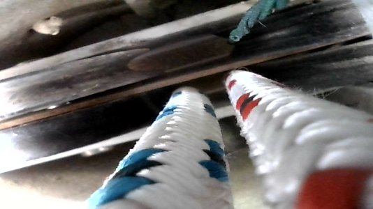

I have been troubled with exactly the same problem, I thought the main/topping lift halyards were tangled as the tension was excessive when hauling them.
I used a drainpipe/endoscope to see what was going on inside the mast, I moused the main halyard and removed the sheave to improve access then hauled the endoscope up, there was no tangle visible but when the 'camera reached the top sheaves it was obvious that the sheave was siezed, so it's a trip up the mast with a screwdriver, water pump pliers and lots of WD-40.
It's not easy to control the endoscope camera when it's 10m up the mast and the limited depth of field means that the exact item you want to look at is seen at it's best but the images are adequate, see the attachment, this shows inside the top of the mast and the sheaves.

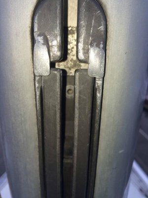

It’s not the sheaves as I was up the mast the other day and they turn easily. Anyone know if I’d have access into the mast by removing the mast gate?
It does feel a bit excessive but would be good to know that could be an option if all else fails.
