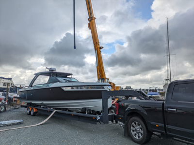

The way thats attached to the trailer is a disaster waiting to happen with a bit of hard braking it will self launch forward.
Hopefully the police pulled him over
old thread but i want my 20cents :D. the boat on the trailer is harder to shift then you might think, the 2 straps pull from either end back to center, the load cant shift unless a strap breaks. personally i would of had a couple more straps over her because 'why not' but its a safe enough tow

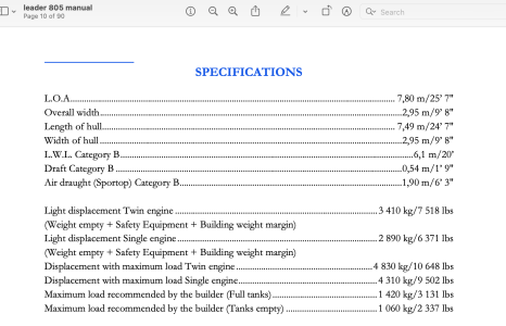

Specs from my 805 manual :Screenshot 2023-12-23 at 15.54.21.png
I think its right on the limit for towing, they are a great boat though

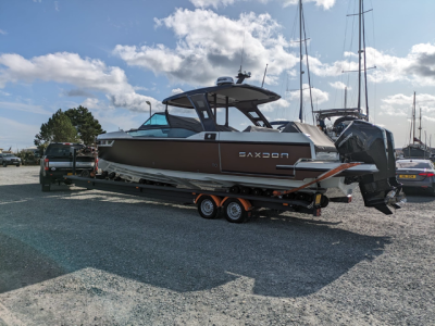

The only other way to tow bigger and he is using a 5th wheel setup - you can go to 4300kg and you need an older style licence with catorory BE (or take the test) - this is a Saxdor 320 GTO 10.28m OAL x 3.10m Beam with a weight of 3600kg
but it will cost you £££££

Specs from my 805 manual :View attachment 169526
according to the specs you posted the only trailer ive found that can tow that so far is a stainless steel jobby that can take 2900kg payload. Although 'technically' it is 2" too wide....i wonder if a ratchet strap round the belly could squeeze 50mm out of her :D

https://powerboatandrib.com/wp-content/uploads/2021/08/Vanclaes-Trailer-Laws.pdf
This is how Power boat and Rib made the legal limits towing an Axopar 28 Cabin - Length was ok, weight was just ok with minimum equipment and fuel/water but the width was over the limit including the overhang, so to reduce the width they removed part of the rubbing strake to make it work ! - I have to say the Van Class trailer looks superb 👍
