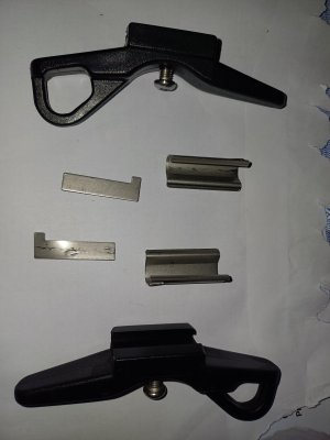

Total rubbish - shroud cleat - failed
Refueler
13 Sep 2008
24,000
Far away from hooray henrys
It didn't even get to having a flag halyard made to it ..
The circular fitting which fits round the shroud just pulled straight out of the plastic cleat.
I can see the design idea - but honestly ... unless someone has a magic suggestion - they will be consigned to the 'great idea - but unusable' locker !
Anyone actually fitted these and success ????

Now that's better than the compression fitting rubbish I paid MORE for !!
Its crossing my mind whether I can use a U fastening round the rubbish I have - save wasting them >
