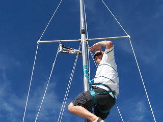

Use a prusik around the mast for a safety and climb the jib halyard in your favorite manner.

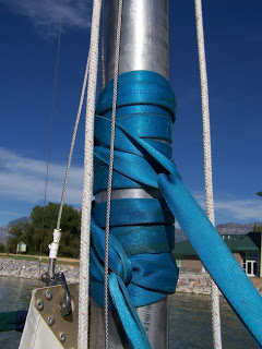

Then use 2 prusiks to climb the mast from the hounds to the top. No different from climbing a halyard, just a little slower. Perfectly safe. In fact, I published prusik holding strengths on a mast:
Mast prusik testing
I had a fractional boat (Stiletto 27) and did this a number of times (Once the Kevlar halyard broke due to flexing, the other time a crew just pulled it up when changing sails). Quite easy, for the few feet you need to go. Any climber should have figured this out in 30 seconds. Barely changes the game plan.

Then use 2 prusik to climb the mast from the hounds to the top. No different from climbing a halyard, just a little slower. Perfectly safe. In fact, I published prusik holding strengths on a mast:
Mast prusik testing

As Thinwater says.. I'd do the climb (with genoa halyard as safety) then use a couple of prussic loops to get up the extra couple of feet..

He did not quote expereince but he did remark that there was no halyard available above the hounds, suggesting he or someone was considering climbing. The mast pruisik system is virtually identical to climbing a halyard with ascenders, which is posted everywhere on the internet, complete with full safety guidance.
So I was actually only pointing out that climbing past the hounds, without a halyard, requires only one small modification of method, which is less well known. (In this case a klemheist, but basically the same thing.)
