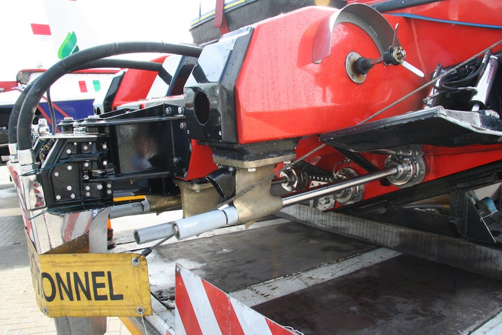

Sorry to get engineery but does anyone know what those drives are? They're not arnesons
They have no flexible joint so the shaft angle seems fixed, and boat trimming must be done by the huge trim tabs.
What are the 4 vertical pipes/struts going to the underside of the swim platform for? The outer two support the aft shaft bearing - you can see the massive bracket bolted to the transom at the top. But they also have flaps and then outlets just in front of the props - I think they're also exhausts. The inner two vertical pipes are probably exhuasts too (they don't serve to support the aft shaft bearing cos that is done by lower big brackets bolted to the transom
It seems a bit odd to fit fixed shaft angles when you could have had articulated arnesons?
Boat is bigger than 48 - I'd agree the 80foot estimate
I think they're like this:
and the big struts lift the units up and down. The bearing housing just doesn't look like it has any articulation.
No doubt someone more in the know will put straight if I am wrong but this my understanding of how it works - the ducts in front of the props are switchable exhaust outlets used to get the boat up on the plane.
When it is running at displacement speed the props are fully immersed and the gearing used is such that the props can't spin up against the water resistance. So, you divert the exhaust from their normal straight thru outlets down through the outlets in front of the props and give it a load of beano, this aerates the water the props are running in, allowing them to slip enuf that the engines get up on their cams/turbos. Then with a bit of luck and a fair wind you can build up sufficient boat speed [about 30- 40 knots] to allow the prop gearing to chime in. Next thing you know you are whizzing along at 80+ knots with just the bottom half of the props in the water.
Well that's my theory anyway.
Paul
BTW, the shafts are fixed - you trim the boat with a combination of HUGE trim tabs and bow tanks that pick up / dump seawater. Steering with those big sharp rudders.
You can see most of this on 'Red FPT' Fabio Buzzi's Cowes Torquay winner from this year. It also has the exhaust ducted down the rear face of the rudders, not sure why- mebbe to reduce the low pressure area behind them?
Thanks scarron - that`sounds the perfect explanation. The vertical doofers are definitely exhausts, and the aeration of the water to make the props slip sounds dead right
Separately, ref your reply to jrb, the pic he posted was of articulated surface drives (arnesons I suspect) not fixed. You can see there are 3 hydraulics for up/down trim and 2 for steering (the centre drive is steered by tie bars, not its own hydraulics). They still seem to have exhaust temporary divert ducts, however. And trim tabs. The customer must have said "just fit everything"
