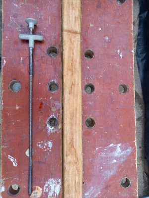

The seized gear lever is a common problem as the plastic seems to absorb water and swell. If you can get it out in one piece it can be sanded down a little and well greased on re-assembly.
gear lever
This worked for me.

It did not come out in one piece despite my best efforts. £20 for a new one.
