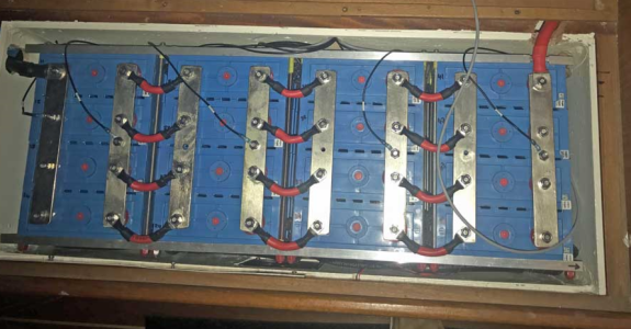

Graham_Wright
30 Dec 2002
7,929
Gloucestershire
www.mastaclimba.com
Yes, but true knowlege is the product of direct experience.
They are obviously fit for purpose, otherwise they would give trouble.
None experienced in 17 years and two boats.
They are 3/8ths of an inch thick, not just light strip.
I used a 316 bolt to connect an anchor winch cable through a bulkhead, The resistance at the joint was sufficient to ignite surrounding woodwork.
Now replaced with brass.
It is interesting (and concerning) to check voltage drop across connection when under load.
