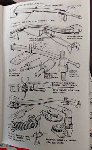

I need more detail. Sketchbook? Pin rail as in line of belaying pins?
PBO used to produce a series of 'Sketchbooks' ... practical ideas for people to use ... i think they did 5 ... I used to have them all .. but they got lost over the years.
Pin Rail .... a straight piece of timber that sat under the tiller, series of holes drilled in that distance between any pair = the tiller width and two pins to put in the holes to lock tiller ... it of course did not have fine tuning like a rope tamer ...
I have a loose leaf folder containing a lot of the illustrated " Sketchbook" individual pages that used to appear in the Monthly Magazine. Skimming through the folder is like going back in time.. :)
