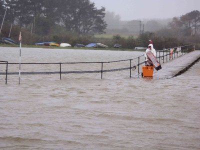

Having made some exact calculations, then note that weather conditions can lead to tides over 1m greater than predicted such as Sunday 20th October when the high tide at Gins Farm was 1.1m above predicted high water.
