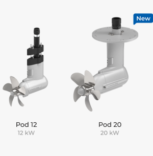

You could get a Epropulsion 6.0 pod drive that just bolts on the bottom of the hull like a sail drive for a couple of grand.
Combine it with a couple of lifepo4 batteries and a generator and you are away.

Really neat idea, but unless available with a bit more power (I'm reading max 9.9hp) would be very underpowered.
6kW masses of power as a “third motor” for a 38 footer on inland waters. Suspect will barely need half that to maintain 5 knots when up to speed. One horse - or even one barge wife! - used to pull a much heavier laden barge.
Clearly would struggle bashing into the tide and strong wind on tidal Thames - but OP says has 250hp x 2 available if more grunt needed for such conditions.
PS. but a saildrive type is probably not ideal for canals if a shaft drive option can be fitted.
99% of the time it would be plenty, and on the few occasions it’s not, just start the main engines.
The cost will go up dramatically as the motor gets bigger (due to more complicated batteries / wiring) for so little gain.
