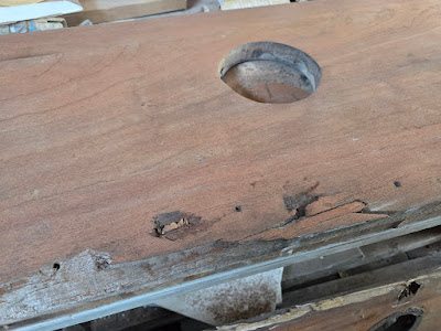

Having got the cabin side out of storage it was time to get them down and put on the bench and sand down both sides and inspect them for damage.
The first bit of damage is on the forward end at the bottom where it was removed without care and as spilt the bottom. This is going to have to be repaired using a grading piece and fixing going up from the bottom edge into the rest of the cabin side to ensure this does not spilt again.

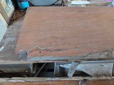

Further pieces missing along the bottom edge which will need pieces letting in, They are behind the carlins so they will not be seen.

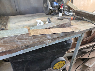

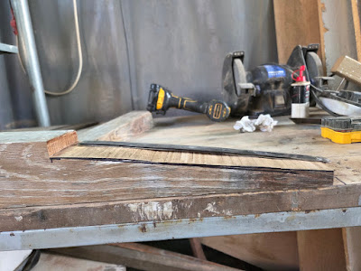

These tow other areas not not so easily covered and will need grading pieces gluing in place and planing down and sanding before the cabin side is varnished again
These two areas will need grading pieces gluing in position as well

Over the past week there as been a lot of of work done on a number of projects from refitting floor bearers in the hull to repairs to the cabin sides and finally repairs to the Samson post which needed a new heal piece making to fit on the lower section of the original Samson post. The majority of the Samson post was in good condition and rather than make a completely new Samson post it was decided that it was just as good to make up a new lower section out of same well seasoned oak we have in the yard and make up a new heal piece. The cabin sides need to have some more major repairs done, however, it was decided that grading pieces were the way to go so these were made up and glued in position. The reasoning behind doing this rather than cut whole section out and gluing new complete pieces in place was that the inside face of the cabin side was not damage and therefore it was not going to need a repair to be seen when it was not needed to be. The next job on Mai Star II will be to makeup a new aft cabin beam and to vertical post to connect the half beams to and then be able to refit the new carlins and refit the cabin sides and front back into position.

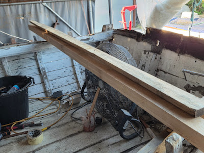

Making the spacers for the hanging knees ahead of the cabin front & making up the two upright posts for the aft end of main cabin to which the short aft deck beams will be jointed into with half lap and half dovetail joints. Also I am making up the spacers to go in between the hanging knees and the deck beam ahead of the main cabin and the grown frame on the hull to make the whole area a ring frame which will tie the deck beam to the hull framing and when the rig is under tension the stress will be spread around the whole structure and not just on one part of the hull. In the meantime, I will be making up studding to bolt the frames to the hanging knees and also the deck beam to the hanging knees.
We are now starting to fit the uprights of the aft end of the cabin so that we can then fit the new aft end of the cabin short deck beams and then the carlins. then once the carlins are fitted along with the short deck beams and the uprights then the cabi sides can be refitted.The first job will be to make up some T&G to make a new aft end of the cabin the way it would have been when Gadfly II /Mai Star II was when she was build in 1939.
