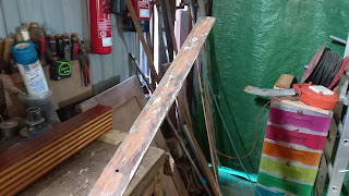

Because the weather is against us at the moment, that is because it is raining heavily and can not go on with the boat itself, so we are getting on with some of the smaller bits and pieces in and around the workshop.
These long pieces being the aft sections of the rubbing strakes which are in need of a good cleaning up and then re-varnishing
Then got to sort out the pile of deck beams and of bits from Mai Star II cockpit coamings and carlins and see which of them need replacing and which can be cleaned up and restored to be used again.
Quiet a pile, just got to dive in and get sorting out the bits and pieces

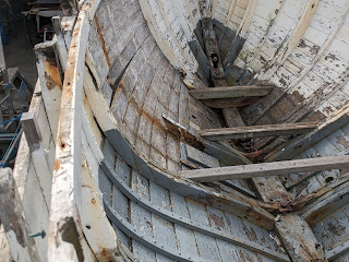

Now that the seacocks and cabin sides are removed from the boat, the boats hull is now exposed so that the major work on the hull can work with an inspection of the beam shelf and the frames and ribs.

One of the most thankless jobs will be to remove all the paint from the inside of hull so that the hull can inspected and checked for rot or other problems which will need to be sorted as we move forward with the project.

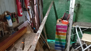

Clearing space for another work station in the temporary workshop in the yard to work on parts from Mai Star II across the yard from the temporary workshop
The temporary workshop is where the boats waiting to come into the workshop are being stored until there is space in the workshop to work on them.

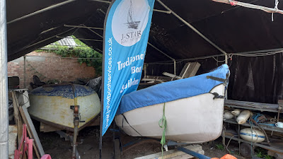

Mai Star II now as her deck and cabin sides removed so that the work on replacing her rotten top of her frames and broken ribs can be worked on easier without the cabin sides and decks being in the way. Just got to put the framework of the temporary shed back up once the parts are welded back together which got broken in a gale a couple of years ago and not had the chance to weld up. That should be done over the next few weeks so that work can start on her shortly.
This cover is only temporary as We are getting the original cover repaired and once that is done then the shed will be well protected for the winter.

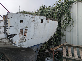

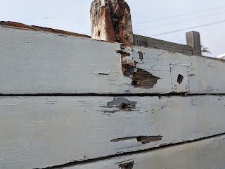

One of the major problems with Mai Star II is her transom which is in need of replacing as there is more damage than would be practical to repair, therefore, it would be a better idea to replace the whole of the transom.

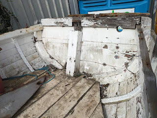

The beam shelf on the starboard side is in reasonably good condition apart from the tops of the frames that need new section fitting on the them to make it possible to fix the sheer plank to them when the plank is fitted.
The port side beam shelf is not in such good condition and will need replacing as part of the restoration of the hull.
The whole of the transom area is in a great deal of attention and will have to be replaced.
This photo shows the ribs are missing as well as the port side frame which will be made up and refitted in this area so that the hull can be brought back into shape once more.

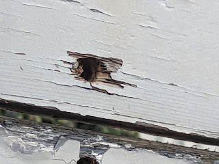

Damage to the planking will have the areas have pieces cut out and bit glued in place and then planed and sanded back to make good the areas.

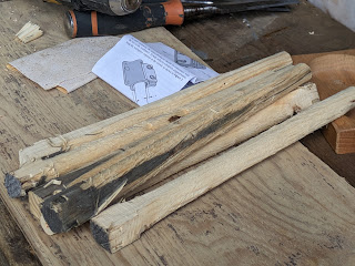

Because the old nail holes are a bit shoot, we are filling them with tapered dowels and then re-drilling new holes for the new ribs to be fixed to when they are steamed in position after the new ribs are made from the green oak we have in the yard outside of the workshop.
There are going to be a far number of these holes that need plugging over the course of the this restoration of Mai Star II, so we better get plug making
First job is to get lengths of softwood turned on the lathe to near the right size and then use the tapered dowel cutter to do the rest of the job.
The tapered dowel cutter used to get the dowels down to the correct size to fit in the holes bored out with the taper plug cutter
The first of many plugs to come
The tapered dowel cutter in operation
