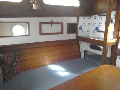

Another vote for tiles. I used Delft as in the photo. The heater was a Victory paraffin which was a brass cylinder type with w Primus stove inside, but could just as easily been a Taylors to go with the Taylors 030 cooker I had.

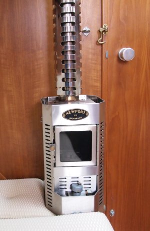

Like onesea my heater (Dickenson) is mounted with a gap between it and bulkhead . It was fitted like that by the previous owner. I was at first wondering if installation was OK but Never had problems and no sign that heat has harmed withe bullhead or cushions.

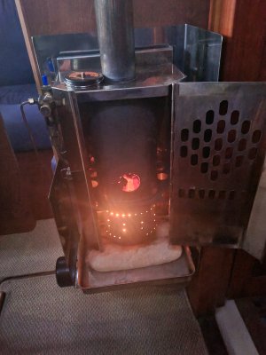

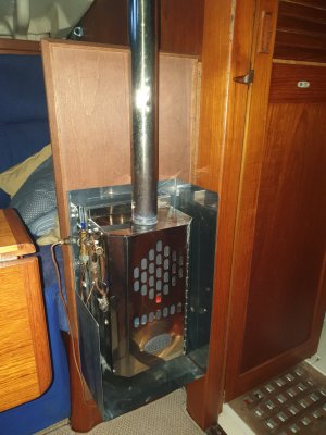

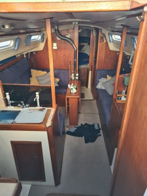

Here's my effort. I had a stainless box made with a cut out for the controls. I had to install a bulkhead as I didn't want to loose the seat in the saloon.
