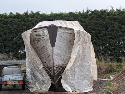

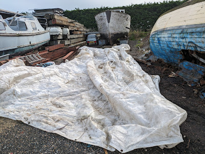

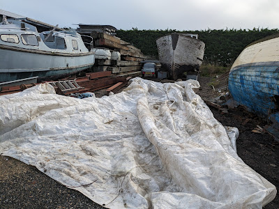

At long last got a cover bigger enough to cover Chance and keep out the weather from the boat while we work on her over the next few months
At long last got a cover that is able to cover the top of Chance and down the sides to keep the weather off Chances's hull and deck and make it able to work on the inside over the winter and beyond.
Now it is just a matter of getting the cover over the stem and over the top of the cabin and the rest of the superstructure and then try it down.

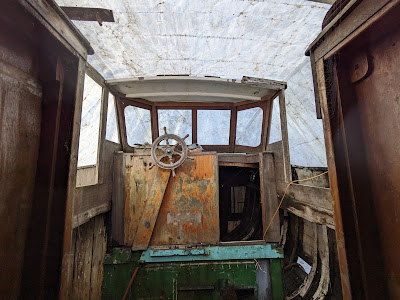

With a bit of careful pulling we were able to get it over the top of the foredeck and then over the wheelhouse and over the aft cabin and now it is done it is time to get to work on the inside as well as the starboard side and transom.

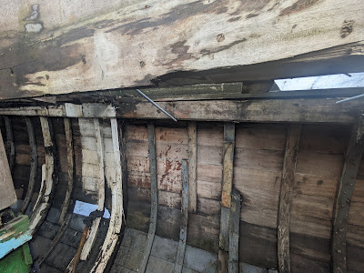

The first job to do over the next couple of weeks, The last two frames on the starboard side of the hull towards the transom & the removal and replacement of the beam shelf.

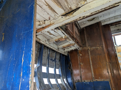

Looking aft at the last two frames on the port side, it is possible to see the problem there is with the starboard side.
The starboard side is rotten and broken and is not connected any part of the boats hull and that the starboard side as fallen away badly and is going to need a lot of shoring up to get it back into the correct position once more.

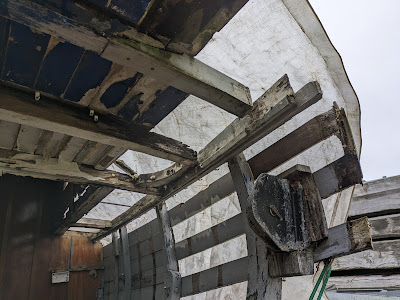

As can be seen from this photo the starboard side is in a very poorly condition with out a lot of connection between the beam shelf and the lodging knees which are all going to need replacing in due course.
This lodging knee is so rotten that the only thing that can be done is to take a pattern of what is left and take another of the port side to see how much of the starboard side knee is missing and make up a new knee to put in place of the rotten and broken starboard knee.
Also the starboard beam shelf is in three pieces at the moment which we will put back in two pieces with a long step scrape in the mid section and will be fixed to the frames and to the carlin with deck beams and tie rods to be the same method as it was when Chance was originally build.

Also the lower part of the rotten frame which needs removing to let the whole of the starboard side be loose to be able to move to whatever position need to move it to to that it back where it should be. So we are going to use jacks and blocks and shores to get the shape back and also block and tackles to pull the starboard back to to the position it should be.As can be seen in the photos the starboard side as moved out by an inch and half from its original position.
The port side although in a poor condition is for the best part in the correct position and we are able to take patterns off the side to make up the starboard frames.
