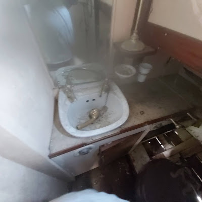

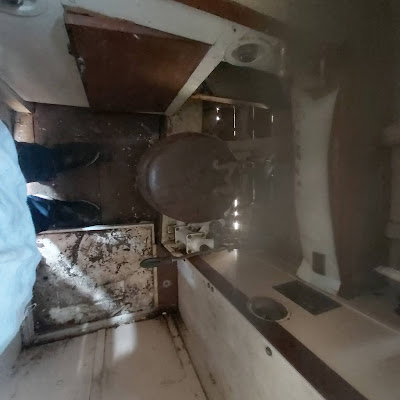

The original heads in the aft cabin with its sink and original toilet
