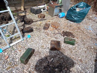

Clean out bilges of dirty water and photograph the weights while they are in position and then they need to be removed to the van and cleaned when back at the workshop, then bilges can cleaned so it is possible to get to planking for painting and inspecting for damage or rot. Get tarpaulins’ to cover up rest of boat, use the sheeting I have in the van and screw in place with battens in van.

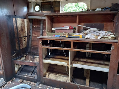

The whole area of the hull above the starboard cupboard now exposed for the first time since Chance was build and now the air can get to the hull to help dry out the area
The galley sink is now removed and so is the upper cupboard so more of the hull is exposed to add getting to the plank fixings so that she can be re-fixed the correct way with copper nails and roves and not just screwed together which appears to have been done on some of the planking that as be replaced over the years.

The next few photos showing the condition of the bilges once the ballast weights were mostly removed some of the remaining weights are in need of a bit more attention to get them out of where they are wedged in position

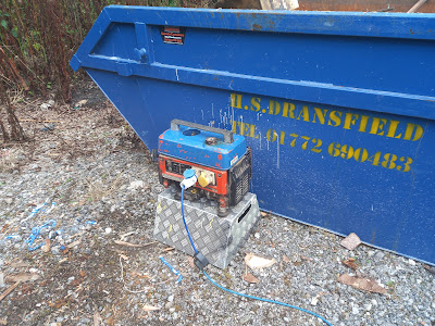

At the moment I am having to use my old small generator as the only form of electric power to power my electric tools and give me lighting in the boat. We I can get some funds available I hope to get a larger generator to give me more power to run more tools and lighting.

Three quarters of the interior ballast removed from the bilges. This was placed from the front end of the main cabin and through the boat to as far back as the forward bulkhead of the aft cabin bulkhead. We worked it out as amounting to about 1 ton of pig iron that was laid in the bilge.
Exposing the hull side in the main cabin exposed a patch of rotten wood in the stringer, thankfully it is localised and the ribs and frames appear to be in good condition. Now the hull planking as a can to dry out now that a cover is over the deck and the air can now circulate around the inside which as not been exposed since 1948.
