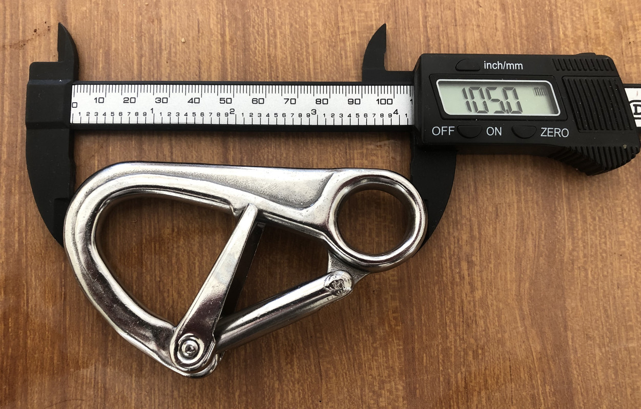

For a small item of boat equipment like a tether hook I don’t see any benefit to using aluminium rather than stainless steel - unless of course you are the sort of racer who used titanium shackles until Dyneema came along...
I've been using steel carabiners onboard on tethers for years(with a grigri), quick wash and occasional spot of oil & they're fine.
GriGri on a harness into short length climbing abseil line, instantly adjustable lanyard length so you can get it as short as you want, works great, clip off to the mast and lean back with both hands free. The grillon would probably be much better suited as it's designed & rated as an adjustable work positioning lanyard.A grigri on a tether? Guess I'm missing something.
