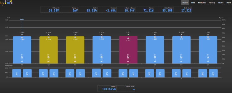

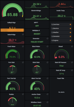

actually the screen before is from grafana, so could get it even on the private ip the one below from the ESP32 running the diyBMS onboard is what I couldn't get from home:
