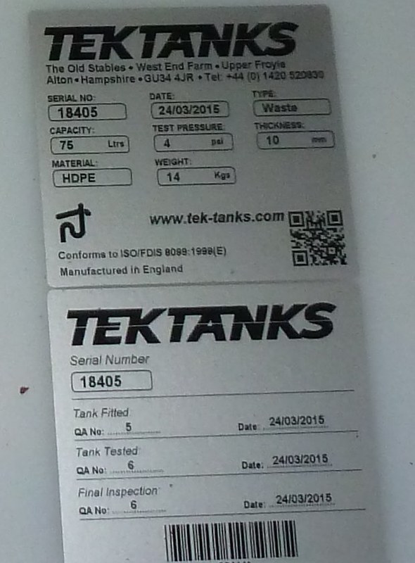

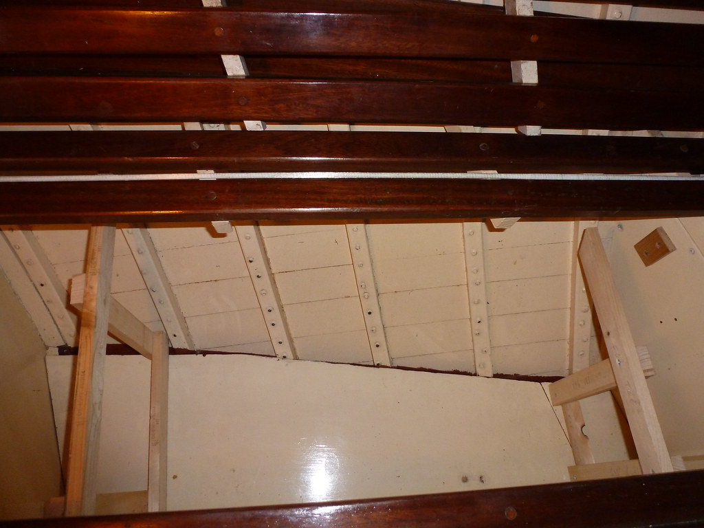

Mocking up and measuring
P1010217 by Roger Gaspar, on Flickr

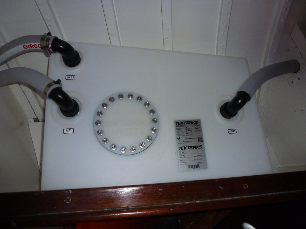

Installed (can't illustrate the bracket locating it)
P1010245 by Roger Gaspar, on Flickr
Details
Label by Roger Gaspar, on Flickr

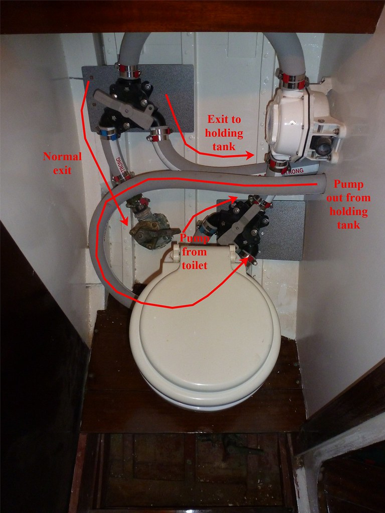

How it works - I assume you have a Lavac (probably the best toilet in the world!). All it needs for a Holding Tank system is two diverter valves. Lower diverter set to either to empty the toilet or the Holding Tank; the upper diverter valve will either exit product from pump to the Holding Tank or Outlet Seacock.
Holding Tank Drawing 1 by Roger Gaspar, on Flickr

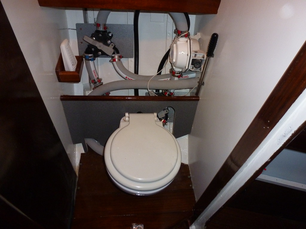

Fully fitted in heads
P1010259 by Roger Gaspar, on Flickr
And now to the detail. A 75 litre tank was sufficient for 4 adults for 3 days easily. Never actually tried for a longer period but there was clearly space. Of course the flushing affects the volume. Note the very short runs which minimise distance loo to tank. The quality of Tek Tank was obvious. I recall it was a quite quick turnaround once I finalised the plans. Tek Tank drawn the final darwings, submitted them for approval and then I think it was about 10 days delivered.
