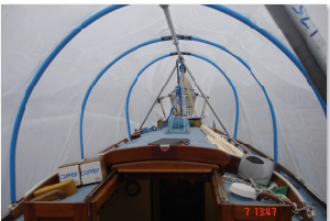

Ref leaving stanchions in position as part of the support system, I have seen covers holding a weight of water bend them quite badly so would not do it myself.
The thing to do is to adequately support the cover so that it sheds water.
This one I made has a tubular steel ridge pole supported on two tubular steel inverted Vs. All connected with proper scaffolding fittings.
The plastic tube frames are placed over the guardrail stanchions.
This lasted through two winters and the only problem I had was when the polytarp was shredded in a severe gale.
