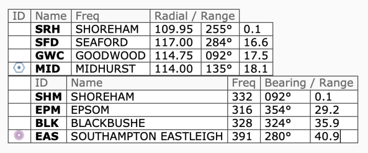

These charts may have some confusion for many. The top chart is not relevant to the discussion on RDF the bottom chart may be.
The topp chart relates to aviation use of VOR visual Omni Range at VHF with amplitude modulation in the frequency range 108 to 118 mhz (117.95 actually) Although the top of the list Shoreham I think if my memory is correct is an error of frequency being in the lower range used for ILS (instrument landing systems.
The VOR has a peculiar signal as recived by the aircraft dpending on location as described by a compass radial from the transmitter. Hence on radial 255 degrees means that the aircaft is 255 degrees from the transmitter and the transmitter is also 75 degrees true heading from aircraft. A vey complex active radar system is used called DME (Distancee Measuring Equipment ) to find distance to the colocated DME transmitter. All very interesting and accurate (although not as easy as GPS) However in practice instrument procedures for an arrival at an aerodrome are not based on identifying where you are on a map but of following particular radial to a particular range then turn etc
Now the second chart does seem to relate to RDF or for aviation ADF (Automatic Direction Finding) The radio is tuned to the beacon or radio transmitter AM band 200 to 400 for NDB (Non Directional Beacon transmitting a morse code identification) or 520 to 1700khz for radio stations (not so safe as identification therefor location is not so clear) The dial will show relative heading from aircraft to beacon. However most larger aircraft have a RMI (radio Magnetic Indicator) Which has a scale rotating to magnetic heading form flux gate. The pointer can be switched from ADF (dual systems usually) to VOR (dual systems usually) So ADF can give effectively a radial from transmitter and VOR can give effectively a relative heading to transmitter. (beacon)
As for the range listed on the second chart that can only be calculated from a map and with no where near that accuracy. So all very confusing.
Now my knowledge of these things relates back 25 years then as an engineer (regulator) and as with boating GPS has changed things rapidly. ADF in planes may soon if not already disappear and RDF in boats is almost forgotten. ol'will
