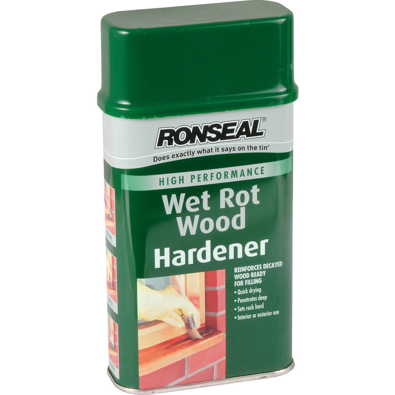

You can get a substance called "Wood Hardener" Once you clear off all the loose rotten stuff you paint it on in copious quantities - let it soak in and harden. It is good at stabilising rotten wood before filling etc.
This stuff?

So called rot-killers, and that includes Ronseal, are useless on plywood. Sorry, there's no long-term alternative to cutting out and making good.

Wet wood hardener bonds with the water to turn the wood into a form of plastic, which is then very good at accepting a two part filler. It does work very well on wet ply, but no structural strength. If your ply started to rot in the middle it suggests fixings have let the wet in or it came down from the top, I expect it's painted and the paint has contained the moisture. If the bulkhead is OK round the outside it still does the job, you wouldn't worry about having an acces hatch in it. I would cut out the rot , tidy and treat the edges carefully then panel over the hole. Probably last for ever.

The Ronseal product is not it - it is essentially a thin cellulose lacquer that soaks into DRYISH rotten wood and sets to be a bit harder than the rotten wood, but has no actual strength. The idea is you then use a two-pack filler over the top. I've used it plus filler often enough on old house windowframes as a 'hold the fort' measure till he window eventually gets either replaced or completely rebuilt.
