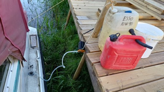

Today used my Oil Extraction pump to top up the fuel tank on the MoBo .... I hate lifting containers to pour in the fuel ...
That's 45lt gasoline in about 8mins ... OK - not fast - but good enough. Added to the 50lts already on board .... good for about 6hrs med cruise ..
Manual says not for gasoline use - but having taken one apart - the rotary pump is sealed from the drive motor ... so as long as you are out in the open to avoid accumulation of fumes - its fine.
Power ? I used the LiFePo4 battery I bought for the E-motor on the inflatable dinghy.

45l in 8 mins doesn't sound too bad.
I always run my diesel through a filter funnel and as a result I doubt I'm much faster than that.
I use a jiggle tube, but I find that simply syphoning with the can at deck level inevitably cuts out with about a third of the can remaining. Lifting the can a couple of feet solves the problem. So I use a running backstay to lift the can up, and lash it to the rail. Takes seconds to set up and works very well.
Having delivered odd boats and also my own - with cans of fuel ... I've always hated trying to pour the fuel. Inevitably some gets spilt ...
But this pump changes all that ... now being 12v - it runs of the boats battery ... and you can leave the can standing and just pump it all into the tank .. being positive displacement - when can is empty - it pumps air through the delivery pipe emptying that as well ...
