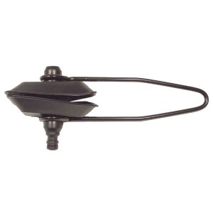

No. It needs a wate supply. A dustbin full of water or a pair of these
