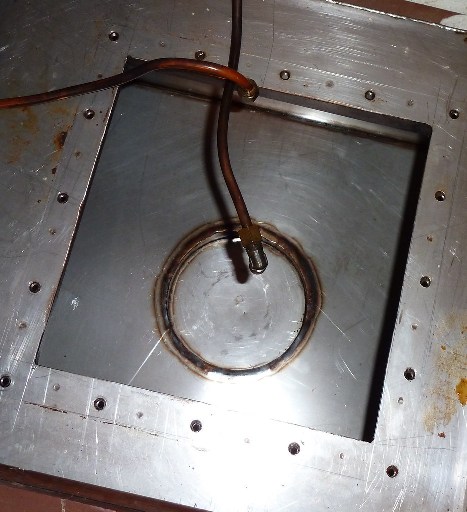

I suppose it must be a headroom problem in TallyHo,notptting fuel tanks in bilge as in photos shown seem the best idea for weight and access
I think so, too. “Tally Ho!” is a big boat, but I recall that she carried and no doubt will carry a lot of inside ballast.
