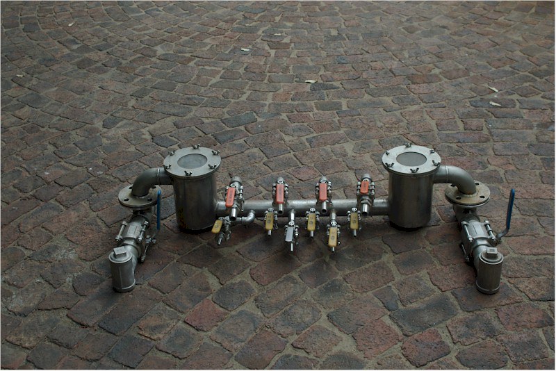

No disrespect to Vic but I prefer to fix the orientation of the tee and the ball valve by trimming the end of the tee with a file so the tee is locked in place by the tee and skin fitting locking face to face. The thread is sealed with sikaflex to ensure the fully sealed thread.
I also use 3 piece ball valves that can be orientation by taking the ball valve apart. It also allow servicing without disturbing any piping work.
fwIb0fPxakyYCb_j1cWtRRyZ7JieHoG3Xhc_51qRTSqRqu5iwUaAbDcmGIZveEWUzqZ23XaIFrOvbYZ-BY0udRKz5yjTQmhQwXPLBnWAxsfv
The plugs on the top of the tee have been changed to a face seal plug with a plastic face seal. Easer to inspect and reseal the plug.
