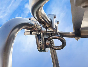

The parts on the OPs first picture look very much like the stainless toothed part that you see on the adjustable fishing rod holders...

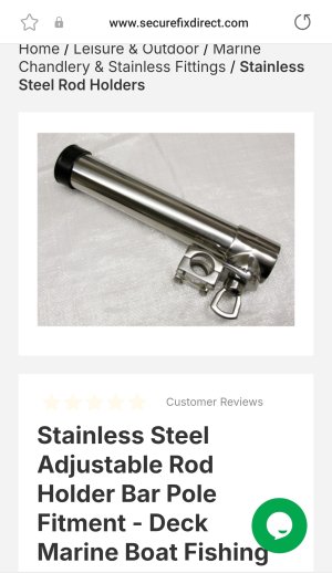

Ignoring the rod holder part, this example contains what looks to be the same adjustable part..

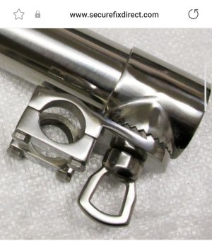

Two of the parts below the toothed section and you'd be there... might be expensive buying two for each side.. but cheaper than buying the whole arch elsewhere!

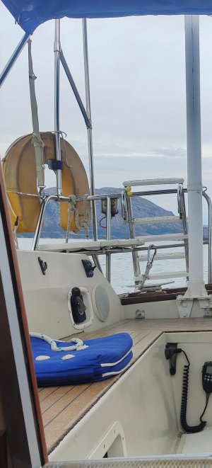

My arch attaches to the horizontal pushpit tube with a pair of these https://www.baselinemarine.com/shopexd.asp?id=19908
The tube heading upwards from it needed a bend of a few degrees which I managed without a bender of any sort, simply careful brute force.
Has been there for well over 20 years now, no problems. The arch carries two panels and is partially supported by the radar pole seen in the photo. The aft arch support goes to a hinged hood fitting bolted to the transom.IMG_20240917_120628~2.jpg
