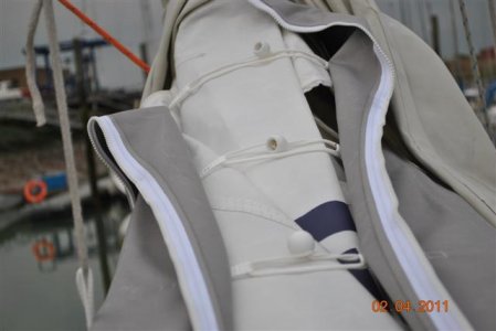

The main issue with stack packs if you want to find one is the long zip jamming due to say dirt or salt plus the pack not being long enough to cover an extended clew . The first issue is really down to replacing the zip after a few years unless you periodically remove and wash the pack and reproof or using some form of lube to easy it during sailing season plus perhaps having a longish rope line on the zipper and just pull in half way when motoring to berth. The second issue is really down to freeing the outhaul . These packs do go green/dirt if in uk at least so annual cleaning might be required or a spray with patio magic type concoction. The body of the pack lasts better than the canvas boot cover on front in my experience. Clearly you don’t need the hassle of a separate sail cover or the nasty elastic fixings or having to fasten what might be a number of elastics to a sail over that doesn’t want to stay on boom even on a small westerly which on a centaur at least had a short low boom. Sail covers are very 70s though so maybe if I had a classic yacht they would appeal.
2 problems easily solved
make the stack pack the correct length- Surely that is not rocket science
Have the zip of a coarse size. I have had both fine & coarse zips & the fine one is slightly harder.
There is another trick to make zipping easy & that is to have internal straps that take the load off the zip.
When I leave port I unzip the cover & leave the straps fastened. That way the halyard does not shake the sail up the mast.
When I drop the sail I fasten the straps & do not bother with the zip until in port or until sea state suits & i know that i will not need the sails. One never knows if the engine is not going to fail at an inopportune moment, so having the sails ready to go is a must in my view.
These ones are not the latest ones but show the idea. My current straps can be located with one hand whilst the other holds the mast in rough weather. I can go forward , tuck the sail into the sail cover, & secure it, then worry about zipping later on. When I do zip there is no struggling to pull the 2 halves together to get the zip started.
Obviously the zip should start at the mast so that one does not have to catch a swinging boom to do this plus one can zip up on the way back to the cockpit rather than make 2 trips.

Agree that clew left sticking out is a simple bad measurement or positioning issue, and easily fixed.
Re zipping up, a lot depends on boat size and boom height. Smaller boats / lower booms then zipping from mast to stern might be easier.
For our boat the opposite is much easier - as zip is too high to engage near the mast. Easier to start at the clew end, standing on the cockpit seats or strong permanent cockpit table. 70cm string on zip enables getting it past the large sprayhood which is always up. Have mast steps to climb up to help zip last bit closed, and to remove main halyard to attach to boom end to stabilise boom (and avoid tapping).
Yes wile it would be easy for the supplier to make one of correct length it’s quite common to find that when suppled new the packs are too short by 2 inches approx. A larger toothed zip does help if replacing. I have never seen those internal straps before but a good idea to retrofit perhaps when the pack is next being cleaned and zip replacement due . I suspect we could manage with just one or 2 - would always have at boom end for reasons stated . The boom end can be winched down subject to the sprayhood height. For the halyard we have a clip like a carbinneer on side of bag to secure back pro tem to avoid it running around front of mast . Only problem with mast steps is the plastic one break due to sunlight after a while.

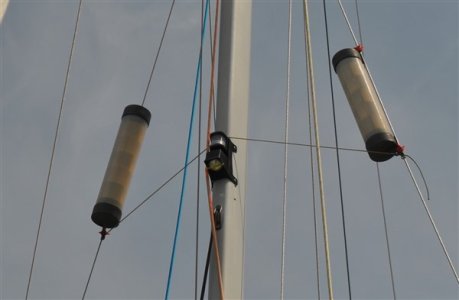

I really do not understand why people have the halyard wrap issue, there is a simple solution & one just needs to take a 4mm cord from one shroud to the one the other side. Mine sits just above the deck light because that is where it used hook round, As for halyard flap just take a bight of the halyard out to the shroud & tie it to that so it is clear of the mast. No need to disconnect from the sail all the time & risk letting it go.

I don’t have that halyard wrap problem with my current boat but once or twice it has flipped round outside the end of the spreader and refused to return. In theory, before motoring off I could secure the halyard with a slip knot in a light line from the cockpit, and I have done this once or twice in the past. On a previous boat I got a halyard wrap round a blipper while on passage but managed to recover it. My method was to attach a weight, a bucket, to the halyard and raise it to the spreader with a control line down to the deck. It was then possible to flick the bucket forwards and then lower it, free it from the blipper and then raise it and recover it, which saved what would have been a tedious trip.
My stack pack covers the clew end nicely and the zip has large teeth and never had a problem with salt etc jamming it. I did have the zip replaced a few years back as the zip material was wearing out.
The covers are washed and treated with fabsil gold and if any stitching looks worn my old singer sewing machine is bought in to use to replace.
