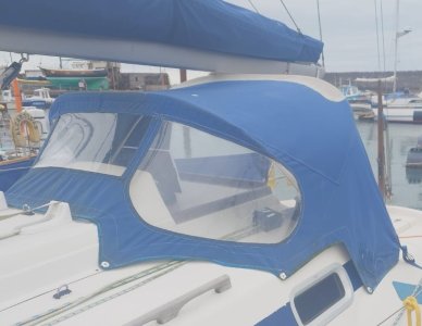

My new to me boat had a (standard looking) blue sprayhood and dodgers (woohoo). I've never had them before.
What type of material should I buy for a patch that is needed?

Don't go cheap.
I bought some canvas that was not expensive but looked a perfect match. However the colour quickly bleached out .
I find the best method is to take the canvas to the workshop that made it . They are happy to carry out repairs eg new windows and a new zip last year . Not for free of course but a lot cheaper than a new canopy.
I was happy with the fabric I recently got from Point North in Cheshire
AC10 - Sauleda Acrylic Canvas, Marine Grade, PU Coated
Www.profabrics.co.uk
Have used Sauleda for sprayhood, bimini, dodgers and sail cover. Last Sauleda sprayhood lasted about 18 years and bimini a bit less, in high UV area. Colour didn't fade much.
Any sailmaker or canvas worker will be able to help you out with a bit for repairs - or do the repairs if you don't have a machine to do it yourself.
If this looks like the right colour, and you only need a repair patch, PM me and i can post you a piece from Northern Ireland EDIT - having difficulty uploading image!
