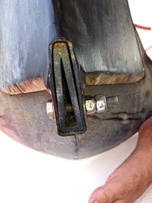

I took off the lock nut and put a breaker bar on the main nut and tightemed the daylights out of it. The shank is a lot less sloppy now. Still seems like a loose fit overall but half of the people I've asked says theirs is the same, maybe just really wide manufacturing tolerances. Will see how she goes
Sorry for foot pic....
Instead of crushing the joint you could simply add a stainless washer, or washers (same number each side) called a shim? Which will work for a side to side wobble.
There does not seem any evidence of corrosion.
Our shank is secured with a stainless bolt and a Nyloc nut + a cotter pin (sort of like a Kirby grip :) ). I never tighten the nut hard.
I would be careful about over torquing. Better to replace that set screw with a plain shank bolt. I used a nut and split pin just to be sure.
What is th Vee slot in the shank supposed to do.
If looks to me that tightening the bolt will just close the Vee slot together.
I would look at taking the anchor apart and hammering a cold chisel into the vee to open it up just a little.
I would also fit some washers on the bolt inside the Vee slot to stop the slot from closing up by movement of the shank in the blade
It doesn't get the chance, it's in the water almost 24/7 😅
Anchors are meant to be in the seabed, not the sea :)
The picture is of the underside of the anchor. The 'V' slot is the end of the shank - its a 'V' slotted mortice and tenon and you can simply see the 'end' of the joint. If the joint is loose I'd try a washer (or two)

I used Spade anchors on two boats while living aboard sailing around the world for 18 years. We spent at least 300 days a year at anchor (that’s about 5500 days or 15 years total!) and experienced every type of anchorage, sea bed and wind condition. I have total faith in the anchor based on massive experience That amount of play is nothing to worry about. Take out the pin and try shaking the plough off and you’ll see what I mean. I suggest at least 5:1 scope on chain and more in shallow water (<5m). The Spade is bomb proof if set properly and I trusted it with our lives.
I spoke to SPADE. they said it's fine. Just to check the bolt. They got plenty of photos etc and just said its all good. Nice company to deal with. Matter resolved
