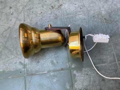

Photo of lamp and failed switch is attached. Any ideas on a source of replacement switch?
Many thanks.

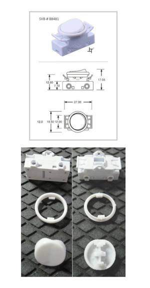

A better photo of the switch would help - is it the white thing to the right?
Anyway, Amazon is probably your best bet. You could try RS, CPC or Farnell (who own CPC) - but you will need to know what you are looking for as they list many thousands of products!

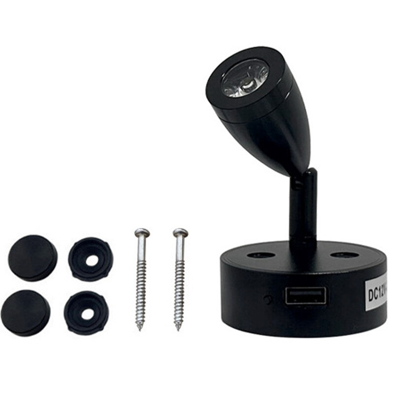

Just a thought - Maybe it's a good opportunity to upgrade. We have something like this on Jazzcat - touch on and off, long touch to dim or brighten, and USB charger socket, albeit not a particularly fast one.
I've fitted 2 just like that in Musketeer's fore-cabin - to replace the non-functioning Moody original lamps (like the OP's)
Many thanks to all of you, but especially to Baggywrinkle, who identified the switch perfectly and pointed me at the supplier. I’ll buy two or three switches and try to keep the old lamps in service. But one day, a more modern design might be just right. 😊

I used Google search to find an alternative at Mouser Electronics.
https://www.mouser.co.uk/ProductDetail/BJB/43.409.U614-001-04?qs=ZcfC38r4Pov8ceTqoFO7Yw==
Note that the switches don’t come with the circular bezel that fits into the brass housing, nor the actual white plastic rocker that fits into the bezel and that you touch. All a bit tricky to fit back together, but this worked: bezel to brass, then switch to bezel then rocker into switch.
