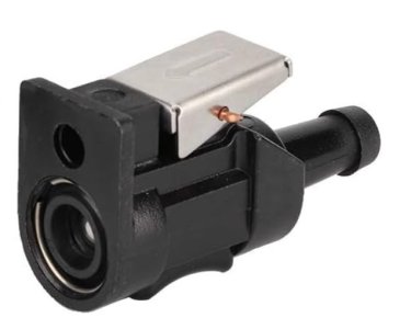

Once again the little O ring inside the fuel line connector for the Yamaha has broken. When this happens fuel drips out the line when unattached and then no fuel goes in to the motor resulting in embarassing conking out.
It seems wasteful to keep buying the whole connector. Sure one can replace the little O ring? Does anyone know what size the O ring is and where to buy one???
Thanks

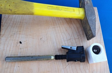

When I did a Johnson O ring I used the method in this video.
O ring replacement
You use a rod or small parallel punch from the hose end to tap out the retaining disc. It all comes apart easily and causes less damage than using picks and levers.

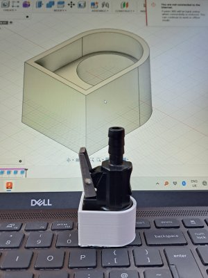

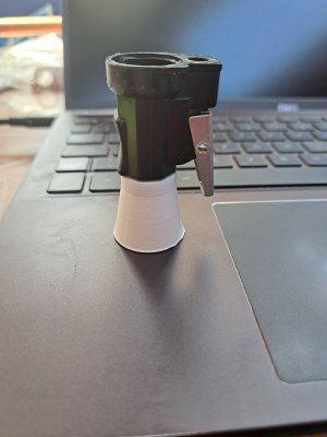

Wish I'd read this an hour ago. I just destroyed the connector trying to get the o ring out. No way can I do it from the engine end. I will now create a holder for 3D printing and try knocking through from the hose end.

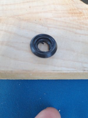

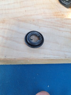

I have now taken out the seal using a block that I printed. It is not an O ring but a tiny lip seal Internal diameter 7mm and outside diameter 17mm.
Now need to find a source for replacement seal and then make a 2nd block to make putting the connector together
