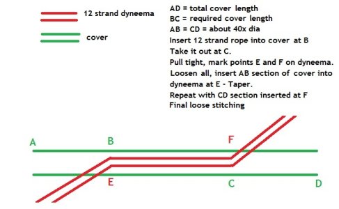

That is truly beautiful! :love: Laborious, but worth it!! Thanks for posting that.
If the OP is otherwise happy with the halyard, and for some reason wants to keep the cover on it, that would be the way to go.
I wonder if the Technora extra cover someone mentioned can be done that way. Would be great to have that grippy stuff where the halyards run through clutches.
