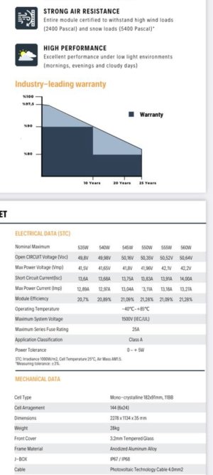

What's the Open Current value of the panels?

Open current 50.35v. 35mm² controller to bus bar, max 1.5M distance. Busbar to batteries around 60cm distance, with original cable around 60mm², I think.

Sorry hi data makes no sense.
50,35 v i a voltage not a current

my mistake!
Open circuit voltage is the right term
