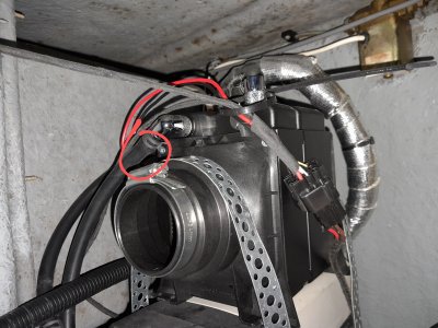

Hi CL
Yes , I originally installed it temporarily sat on top of my temporarily installed Chinaspacer, see attached picture. Very straightforward to fit . You choose between water or warm air via the changeover flap. Surprising how little heat exits the bobil exchanger, so its obviously transfering well
It came with a control with two temperature sensors, these weren't required for my installation. I just wanted a simpl on off switch. I will get around to making a more permanent instalation eventually.
Works a treat , around 30 min gives piping hot water. Just got to remember to turn on the supplied 12v circulation pump . I forgot once and popped a heater pipe . Just a rubber tube exiting the heater.
If you have fresh water cooled engine , I would choose this route over the Bobil. My Bukh is raw water cooled and not sufficiently warm enough to heat the calorifier to a bug free environment temp. Very good at providing hot water ar anchor.

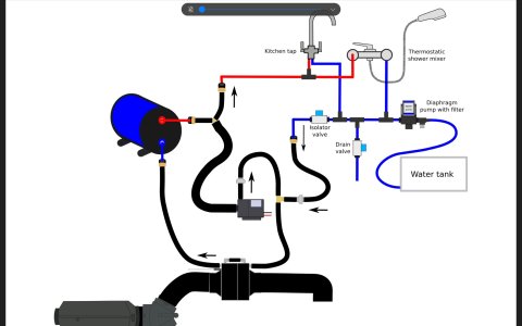

Its tee's into the pipework as in attached diagram. The one way valves shown are all in the kit . You only get circa 1mtr of 10mm id. Rubber pipe in the kit, so I fitted 15mm push fit as I needed around 3 mtr. Also gives a much better flow rate . If you follow the diagram you can see the cold feed from your existing tank / freshwater pump pushes through the heat exchanger (Bobil ) then into calorifier ( cold in tapp )then out to hot feed . So technically its a direct exchange as opposed to indirect ( via coil from engine) . To put it simpler the water inside the Bobil eventually exits your tap.
If it was indirect ( via coil ) it would simply boil inside the Bobil as it couldn't transfer heat to the contained domestic water fast enough.
Hope this makes sense.

The Bobil isn't plumbed into the coil ( the circuit your engine is plumbed to).
Ah I see! I was confused about whether to use it direct or plumb through the coil... So it just circulates it and heats it as it goes round... Makes sense.

If you decide to do the KIS route like me ,and omitt the control. Have something in place to remind you to turn on the small 12volt pump before you change the flap over too th Bobil heater. I forgot on one occasion. Turned on heater ,switched over to water heating, descended the lader to do some antifouling preparation, a few minutes later ....POP steam exiting my locker.I really thought ide damaged my heat exchanger on the Bobil..Luckily it had just split one of the rubber tubes that connect the Bobil to my 15 mm push fit.see pic
Replaced like for like as its a good failsafe. Cleaned my bilge aswell.
