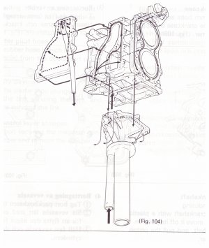

You could be right but this is the water circulation diagram for the Yamaha 15 which may be similar to the Mariner 15.
The pipe on the left leads to the pee hole and on mine if this blocked the engine would overheat. Anyway it is a good indication that the impeller is working.
