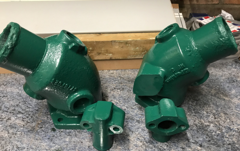

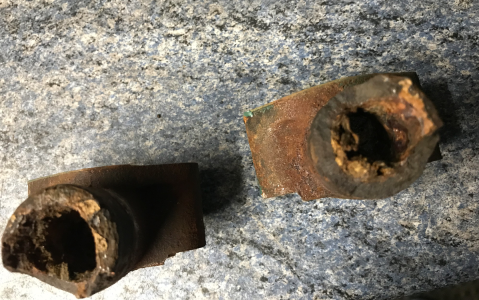

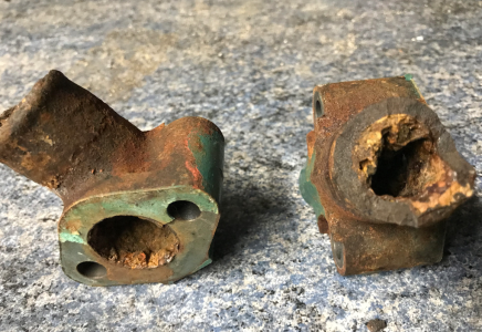

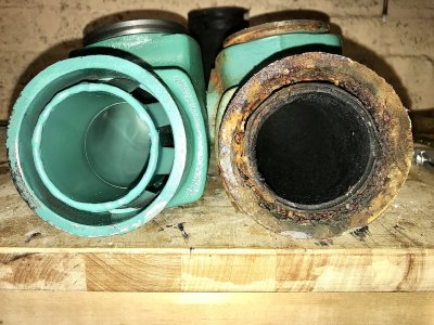

Water injection elbow, only need to remove the small bolt on part to check, not the whole exhaust elbow.
