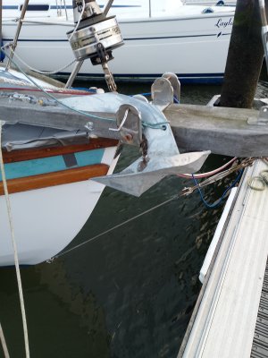

Good point about locker location, ours is right at bow and just under the deck, not low under forepeak like many designs. You can see the locker drain holes well above water line

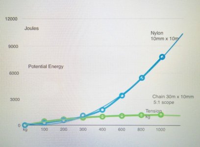

This is a comparison of the snubbing, snatching. ability of your 10mm chain and our 10mm nylon. With a snatch load of 650kg (35knots of wind) and 30m of chain deployed at 5:1 the chain 'absorbs', maybe 1,000 joules. 10m of 10mm nylon, no chain 'absorbs' 4,000 joules. I know you can deploy more chain - how much do you need to carry. Our 10mm nylon outperforms 10mm chain by a factor of 4 - and we still have the 6mm chain. as back up. As the wind increases chain becomes less and less useful - call it a liability

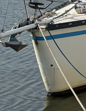

Yes, allows greater room in the forward cabin. You could have saved a bit more weight by choosing a 10kg version of your Epsilon as I did
