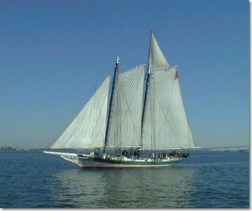

Rum_Pirate
23 Aug 2004
27,773
A tiny Island, Caribbean
You decide
The type derives from pilot boats as did the Baltimore Clipper. The raked masts and fine lines show an effort at attaining speed. At various times pungy schooners served as cargo carriers and oyster dredges. They were replaced in the oyster trade by the skipjacks which survive to this day
