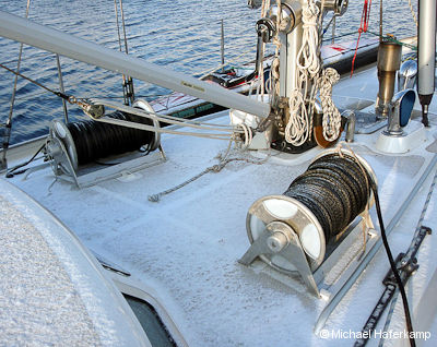

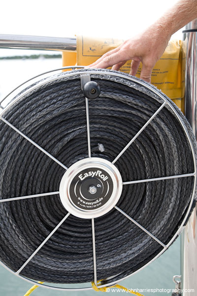

There are many expedition boats that use Spectra Dyneema where the ultimate strength of a shore line which is pre tensioned is more important than the stretch. If I could afford it then I would. Par example:

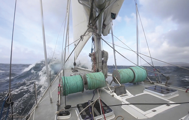

Skip Novak uses polypropylene too (prominently placed on large reels either side of the mast). And the sailing he does definitely qualifies as "adventurous places".

The stuff shown on the reels on Pelaigic Australis is probably seasteel: http://www.gaelforcemarine.co.uk/en/Gael-Force-Seasteel-Rope/m-764.aspx
It's proper high quality rope and about as different from the horrible bright blue polyprop as it's possible to find. One of the key differences is that the blue stuff is made from fibres split from a raffia like tape whereas proper polyprop ropes are made from multiple strands of single spun fibres.

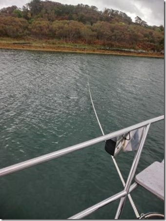

PS: weather to be in a sheltered anchorage:
with a line (nylon in this case) to a tree!
